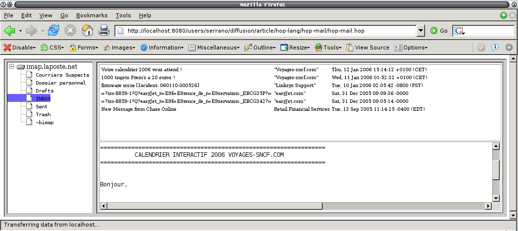

In this section, we show a small Hop application. We present an overly simplified IMAP client that uses a web interface. As shown in the screenshot of Figure 15, it presents a table with two columns. The left column displays the list of folders found on the IMAP servers. The upper right column shows the list of messages of the selected folder. The lower right column shows the body of the selected message. The application is interactive. Folders and messages are accessed on-demand using mouse clicks.
Hop provides a library for accessing IMAP servers. All the function that belong to this API are prefixed with imap-. This API being self explanatory, it is not discussed here. In order to make the application as compact as possible, we don't provide the IMAP client with a GUI for connecting to the IMAP server. Instead, the connection to the IMAP server is held in a global variable:
(define connection (imap-login (make-client-socket "imap.laposte.net" 993) "foo" "XXX"))
Then comes the heart of the application. It uses two Hop widgets, <TREE> and <PANED> which are popular widgets in traditional GUI programming and which are supported by Hop. This is presented in Figure 16.
(let ((folder (<DIV>)) (message (<DIV>))) (define message-show ...) (define folder-summary ...) (define (<IMAP-TREE> connection) ...) (<HTML> (<HEAD> :css "hop-paned.css" :css "hop-tree.css" :css "hop-mail.css" :jscript "hop-paned.js" :jscript "hop-tree.js") (<BODY> (<PANED> :fraction 30 (<PAN> (<IMAP-TREE> connection)) (<PAN> (<TABLE> :width "100%" :border "2px" (<TR> (<TD> :class "folder" :valign 'top folder)) (<TR> (<TD> :class "message" :valign 'top message))))))))
The two <DIV>s, folder and message respectively contain the list of folders and the body of the selected message. The left column of the application is a tree whose label is the name of the IMAP server and whose leaves are labeled with the names of the folders.
(define (<IMAP-TREE> connection) (<TREE> (<TRHEAD> (socket-hostname connection)) (<TRBODY> (map (lambda (f) (<TRLEAF> (<TT> :class "summary" :onclick ~(with-hop ($folder-summary $f) (lambda (h) (set! $folder.innerHTML h))) f))) (imap-folders connection)))))
When a leaf of this tree is clicked-in, the service of the main stratum folder-summary is invoked with the name of the folder. The result of this function call fills the folder <DIV>. This is presented in Figure 17.
(define folder-summary (service (folder) (imap-folder-select connection folder) (<TABLE> :class "summary" (map (lambda (mh) (<TR> :onclick ~(with-hop ($message-show $folder $(car mh)) (lambda (h) (set! $message.innerHTML h))) (<TD> (imap-header-get mh 'subject)) (<TD> (imap-header-get mh 'from)) (<TD> (imap-header-get mh 'date)))) (imap-folder-headers connection)))))
The service folder-summary builds a table with three columns containing respectively the subject, the author, and the emission date of the message. When such a message is clicked, the service message-show is called with two parameters, the folder name and the message identifier. The result is used to fill the message box.
3: (define message-show 4: (service (folder msg) 5: (imap-folder-select connection folder) 6: (<PRE> (imap-message-body connection msg))))
